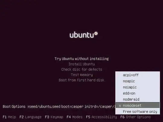

2. Black/purple screen when you try to boot the LiveCD
The Ubuntu installer's startup portion is sometimes incompatible with certain graphics cards. Fixing it and getting to the Ubuntu Desktop to try or install it can often be surprisingly easy fix: the nomodeset parameter. To see if it works for you:
Boot from the Desktop Live CD and press the ↓ key when you see the below:
Press Enter and select English:
Press F6, use the ← ↑ → ↓ keys to go down to
nomodeset, and press Enter. An x will appear to its left. Then press Esc, and press Enter to "Try Ubuntu without installing."
You can also try acpi = off and nolapic if nomodset also shows up as a black screen.
